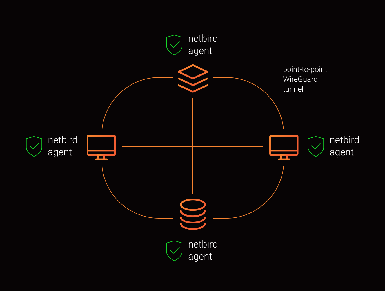

Alternatively, you could add and/or configure your IoT devices to become part of a mesh network. For instance, NetBird is an open source mesh VPN platform that lets you quickly join peers in your mesh network simply by installing the client and authorizing the new peer. It makes for a zero-config VPN experience that you have to experience for yourself.
Built on top of the performant and lightweight WireGuard VPN protocol, the NetBird mesh network is secure and easy to configure. It supports many different operating systems and can even be installed in a container system like Docker.

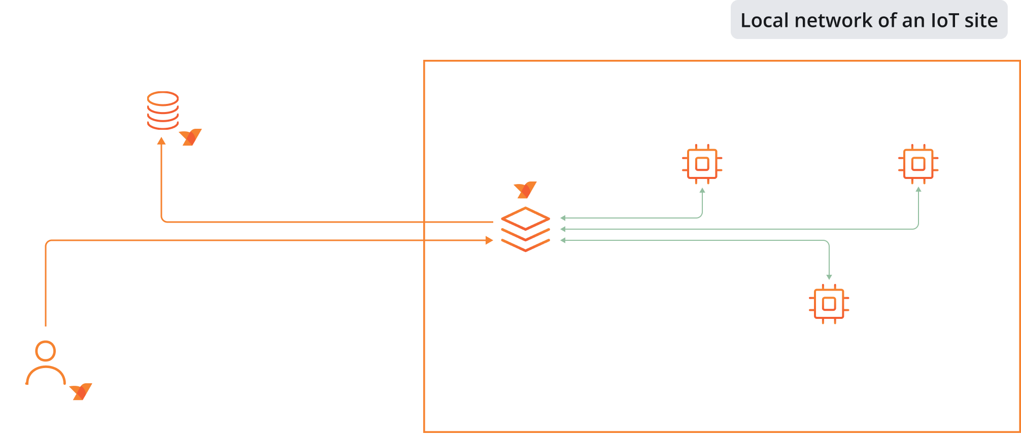

Because NetBird supports installation on so many different operating systems, you can install it on any PC acting as a router or even an OpenWRT-compatible router:
While you don't have the central data-gathering capability of an IoT gateway, you effectively have the same protective isolation as long as the router or PC is configured to connect only to other mesh devices. This makes your IoT devices accessible only from other mesh-connected devices, which could even be a mobile phone of an administrator if needed. Storing data collected by the IoT devices in the cloud or any remote storage becomes an easy task a well, as the gateway can have a direct connection to the storage system.
With the network address translation (NAT) traversal capabilities of NetBird, you should get a direct connection to your devices without resorting to special networking configurations.

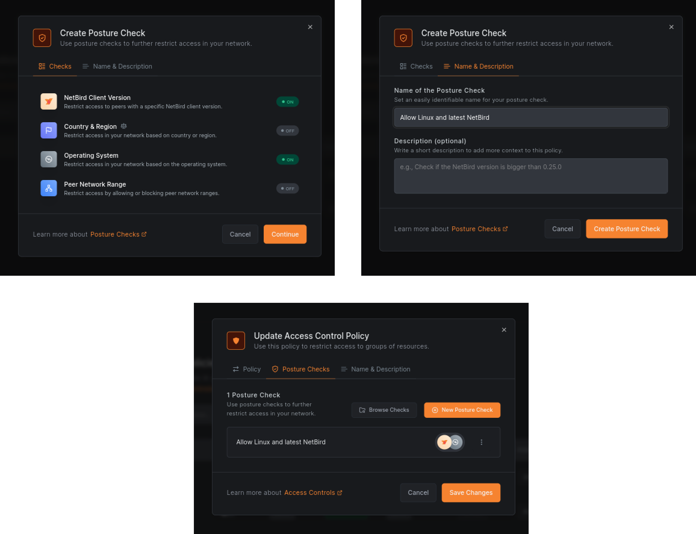

Posture Checks
The NetBird client can be configured to allow only devices that meet a certain security posture. The posture checks are configurable and can be set to check certain variables before allowing a device to make a connection. Some of these variables include but aren't limited to the following:
  • NetBird client version check
  • Geolocation check
  • Network location check
  • Operating system check
Only once a client has passed all the checks will it be allowed to connect to any device or resource on the mesh network.

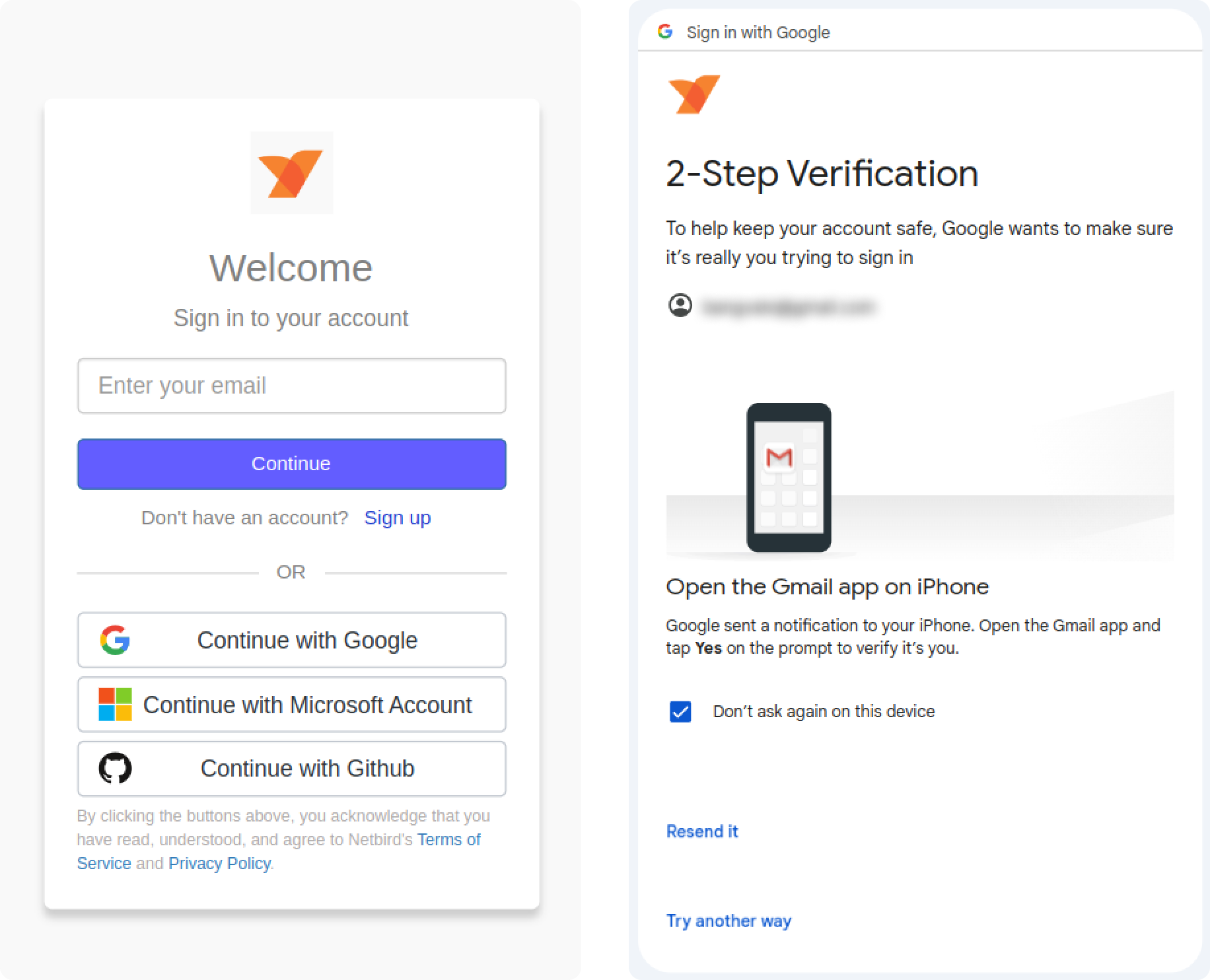

NetBird fully integrates with your existing identity provider, and you can enable security measures such as SSO and MFA.
