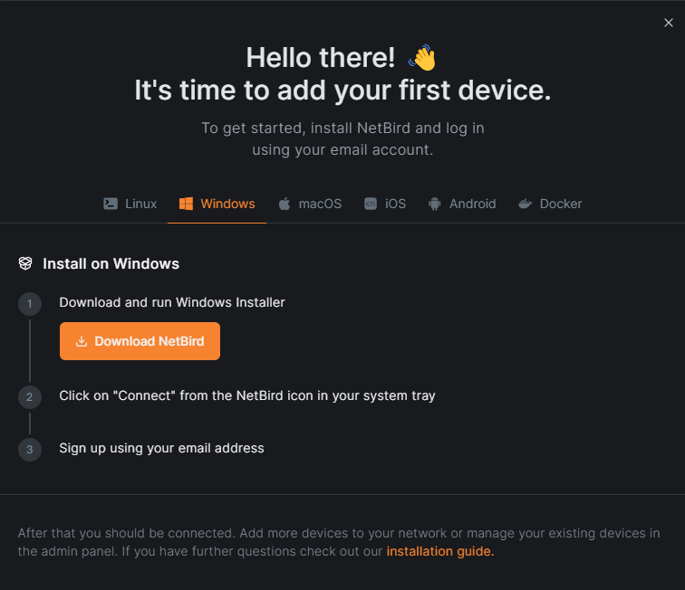

Once you've signed up and signed in, you'll be greeted by a screen offering you the download links for the NetBird agents of different OSs:
This guide uses a Windows machine and a Linux machine, and you need to follow the instructions for installing the agent on two of the machines you want to connect.

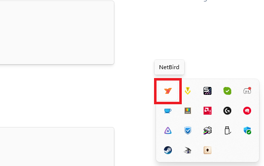

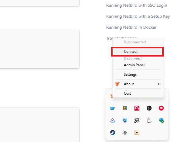

On the Windows PC, right-click the NetBird agent icon running in the system tray and select Connect:

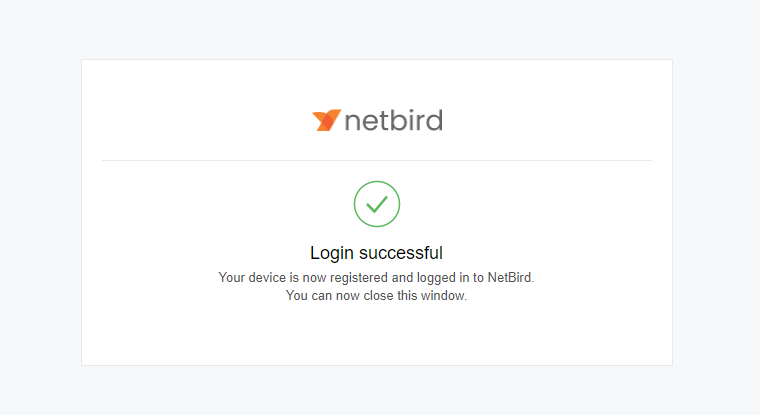

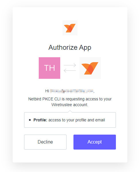

If you're already logged into your NetBird console, you should get a browser window that opens up and asks whether you want to authorize this device to your network:
Once you click Accept, your device will register with the NetBird service and become the first peer connected to your mesh network:

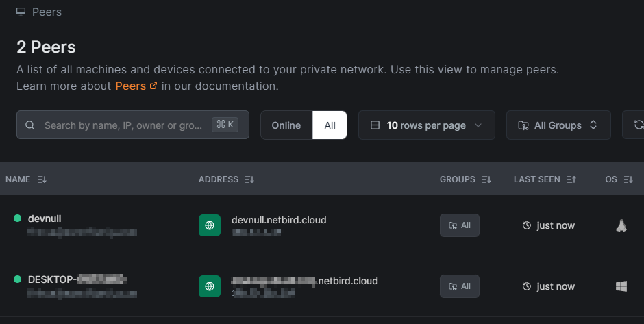

Once you've verified you want to join the network, you can see them listed under the Peers panel on your NetBird dashboard:

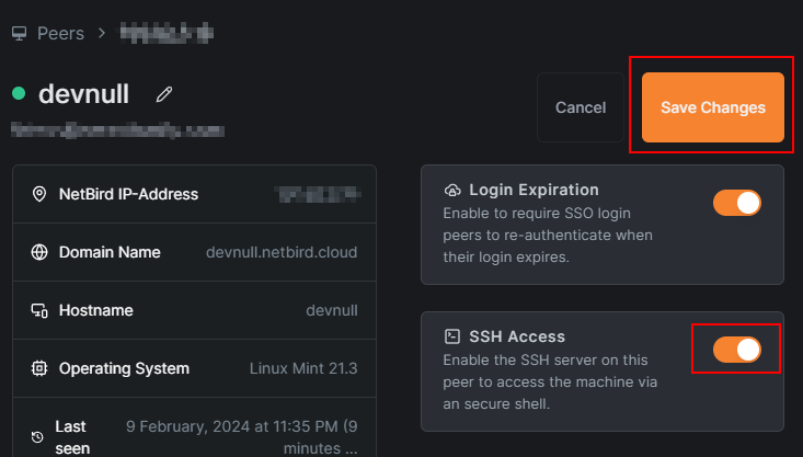

Once the peers are all connected, you need to enable the NetBird SSH Access feature from the dashboard. Simply click on the peer that you want to access via SSH and then toggle the SSH Access option.
You will receive a warning that this is an experimental feature, but it's perfectly fine to enable it for this tutorial:
NetBird will now run an SSH server that is accessible only from other computers on the peer-to-peer mesh network.

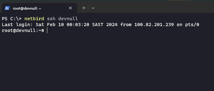

Now, from your other machine, you can SSH into the computer that has SSH access enabled simply by running the following command in a command prompt: .
In this case, the Linux box that has SSH access enabled is called . NetBird automatically creates a DNS server and DNS entries for all peer-connected devices, so the command for this tutorial is as follows:
And that's it! You've made an SSH connection to the other machine without having to distribute anything. The connection is also secure as it's accessible only via other machines connected to the mesh network and it's not internet-facing.
