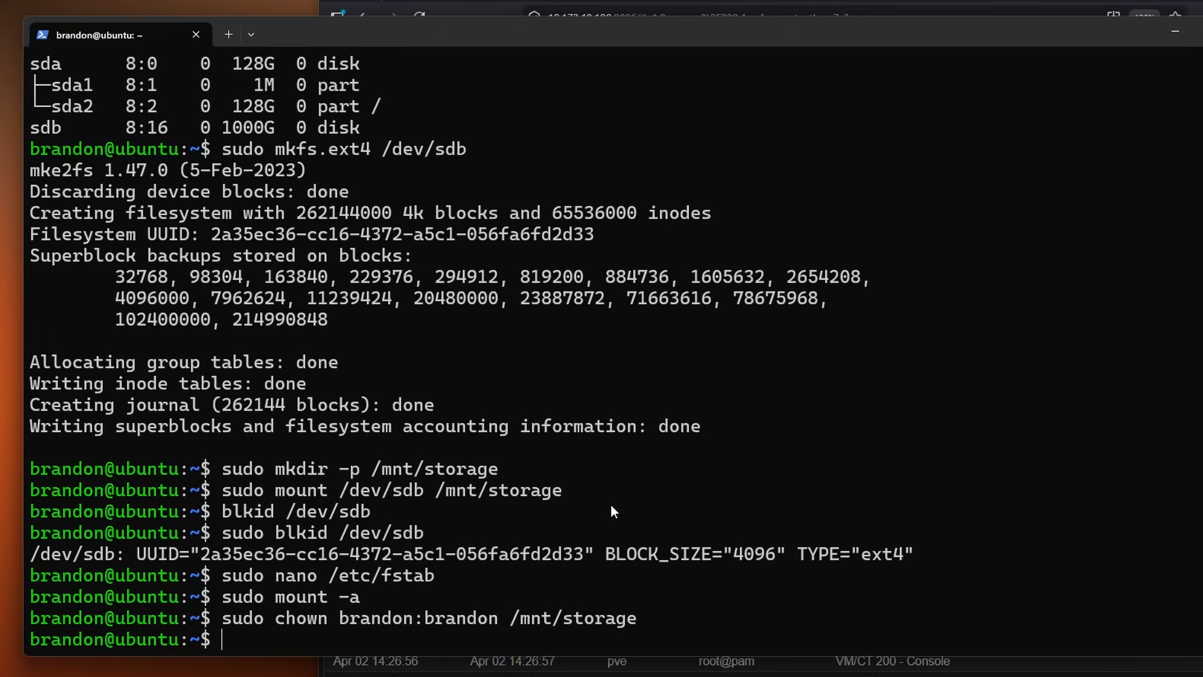

Option 2: Custom Directory with NFS or SMB Mount
If you have a NAS or dedicated storage server, you probably want Nextcloud's data living there instead of on the local disk. The way to do this is to mount your network share on the Ubuntu host and then tell Nextcloud AIO to use a folder on that mount as its data directory.
First, install the packages you need for your mount type:
For NFS:
For SMB/CIFS:
Create a mount point on your system:
Then add the mount to so it persists across reboots.
NFS fstab entry:
SMB fstab entry:
For SMB, create that credentials file so your password isn't sitting in fstab:
Then lock it down:
Mount everything:
Verify it's mounted:
Now create the folder that Nextcloud will use:
This path is what we'll pass to the AIO container later. Do note that the folder needs to exist before you start the container, otherwise AIO will throw an error.

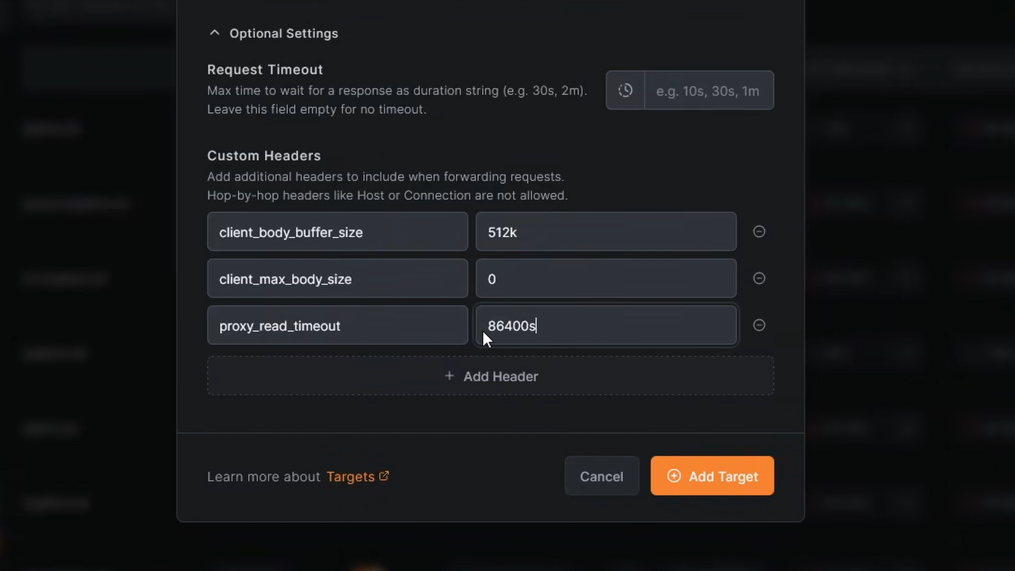

  4. Still in the target settings, open Optional Settings and add these custom headers:
    These matter for Nextcloud specifically. The buffer size handles chunked uploads more efficiently, setting max body size to removes the upload size limit entirely (otherwise large file uploads will fail), and the read timeout gives long-running uploads a full 24 hours before timing out.

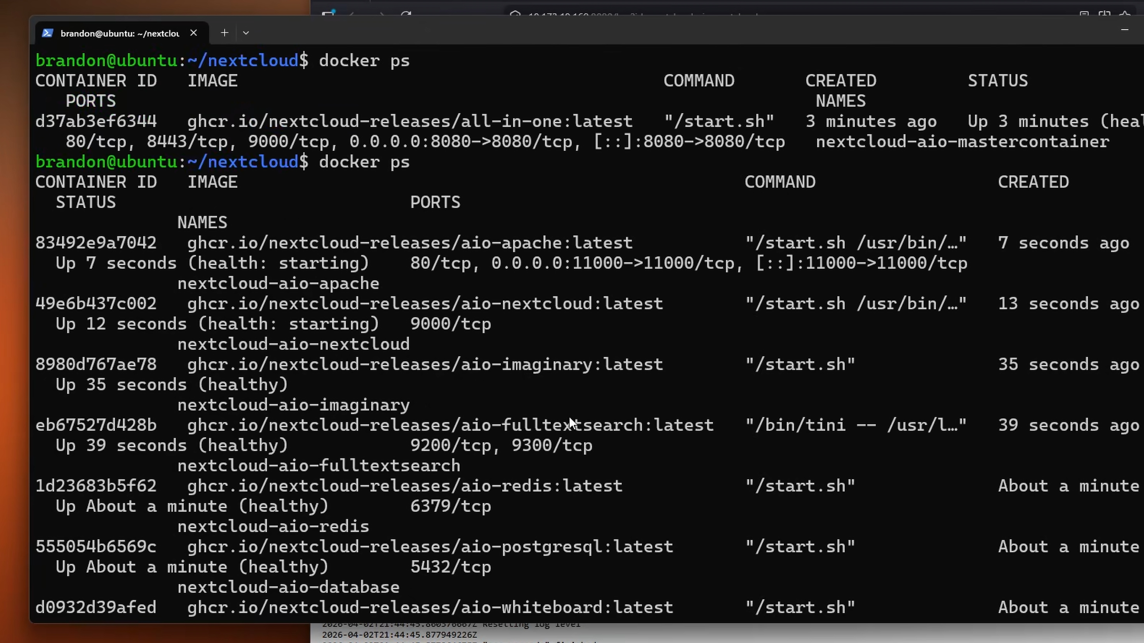

Now start it up:
Give it a minute to pull the images. You can watch the logs with:

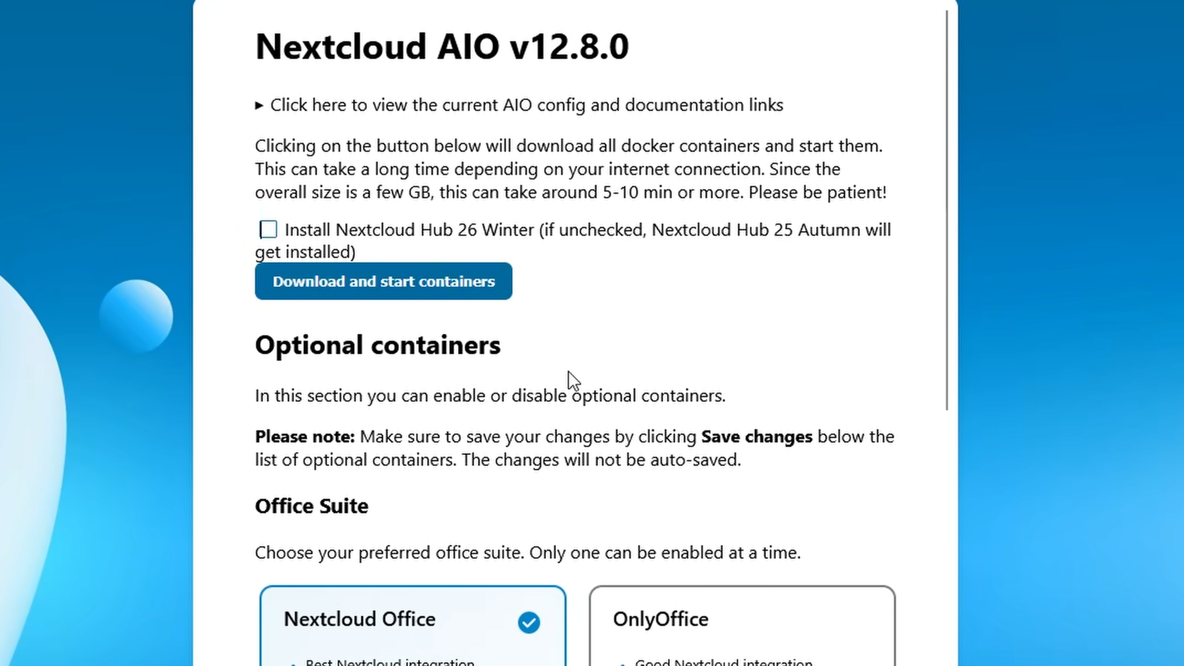

  4. Click Start containers to deploy everything
AIO will pull and start all the selected containers. This can take a few minutes depending on your internet connection and how many optional containers you enabled. Once everything is green, Nextcloud is running.
Now go to in your browser. You should see the Nextcloud login page, served over HTTPS through your NetBird network. The initial admin credentials are shown in the AIO admin interface, so grab those and log in.

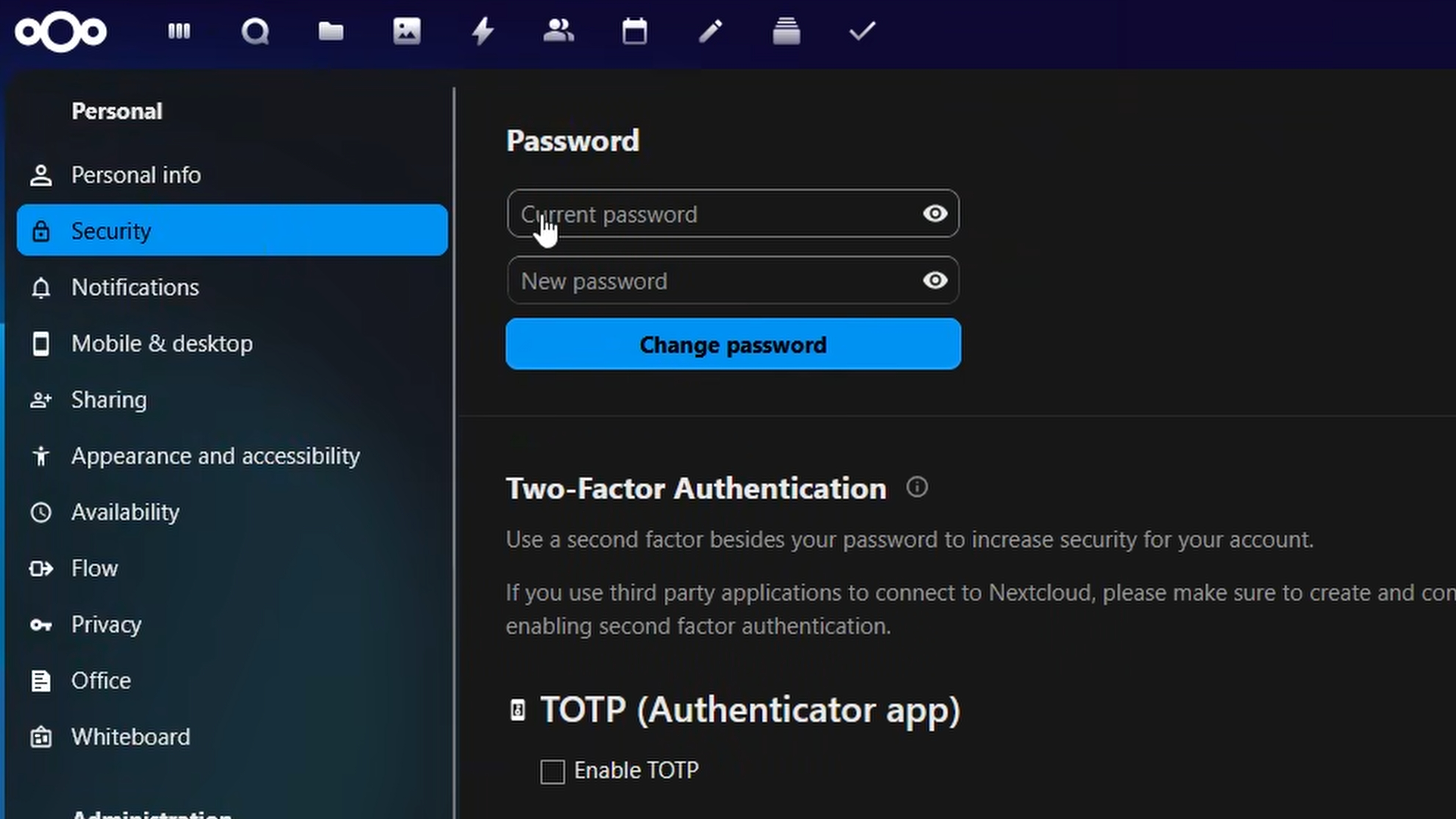

Change Your Admin Password
The first thing you should do after logging in is change the auto-generated admin password. Go to your profile in the top right, click Administration Settings, then navigate to Security. Enter the current password and set a new one that's strong and something you'll actually remember. Don't skip this — the default password is long, random, and easy to lose track of.
