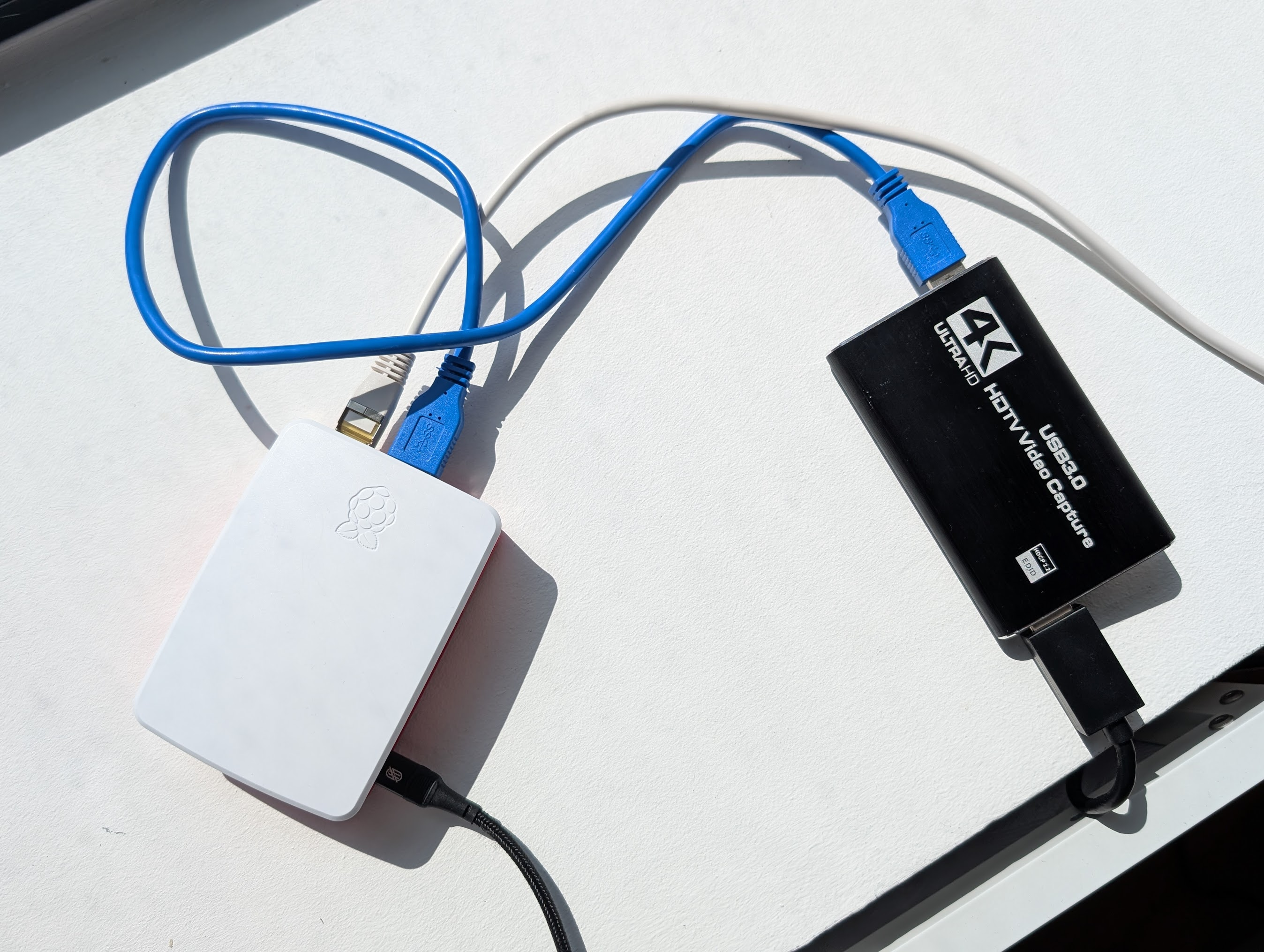

Video capture device - This is what captures the HDMI output from your target machine. You have two options:
- HDMI-CSI bridge (recommended) - Based on the Toshiba TC358743 chip. Connects to the Pi's CSI camera port. Supports H.264 hardware encoding, automatic resolution detection, and has the lowest latency. This is the preferred option.
- HDMI-USB capture dongle - The cheap dongles you see everywhere on Amazon. They work, but only support MJPEG (heavier on bandwidth), have no resolution detection, higher latency, and some users report compatibility issues with BIOS screens. I'll be taking this route today.
Power supply and USB connectivity - This is where it gets a little tricky. The Pi 4's USB-C port needs to simultaneously receive power and act as a USB device (to emulate a keyboard and mouse for the target machine). You need a USB-C splitter that separates power and data:
- Easiest option: A USB-C power/data splitter module (available from the PiKVM team or third-party sellers), a USB-C to USB-C cable (Pi to splitter), a USB-A to USB-C cable (splitter to target machine), and the official Raspberry Pi USB-C power supply.
- Budget option: A USB-C Y-splitter cable with a USB power blocker on the data leg, plus a USB-A to USB-C cable and any 5V 3A power supply.

Once flashing is complete, insert the microSD card into your Pi, connect the hardware (HDMI capture, USB splitter, Ethernet), and power it on

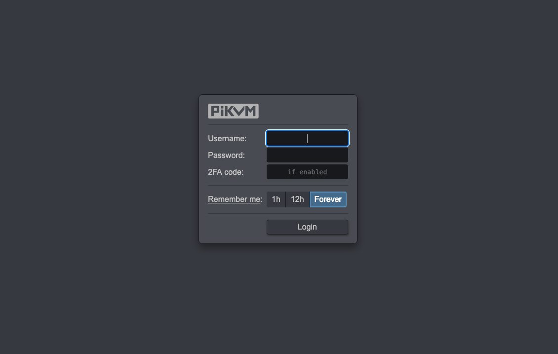

The first boot takes a couple of minutes. Once it's up, you can access PiKVM by navigating to or in your browser. The default credentials are:
- Web UI: username , password
- SSH/console: username , password
Important: Change the default passwords immediately. SSH in and run .

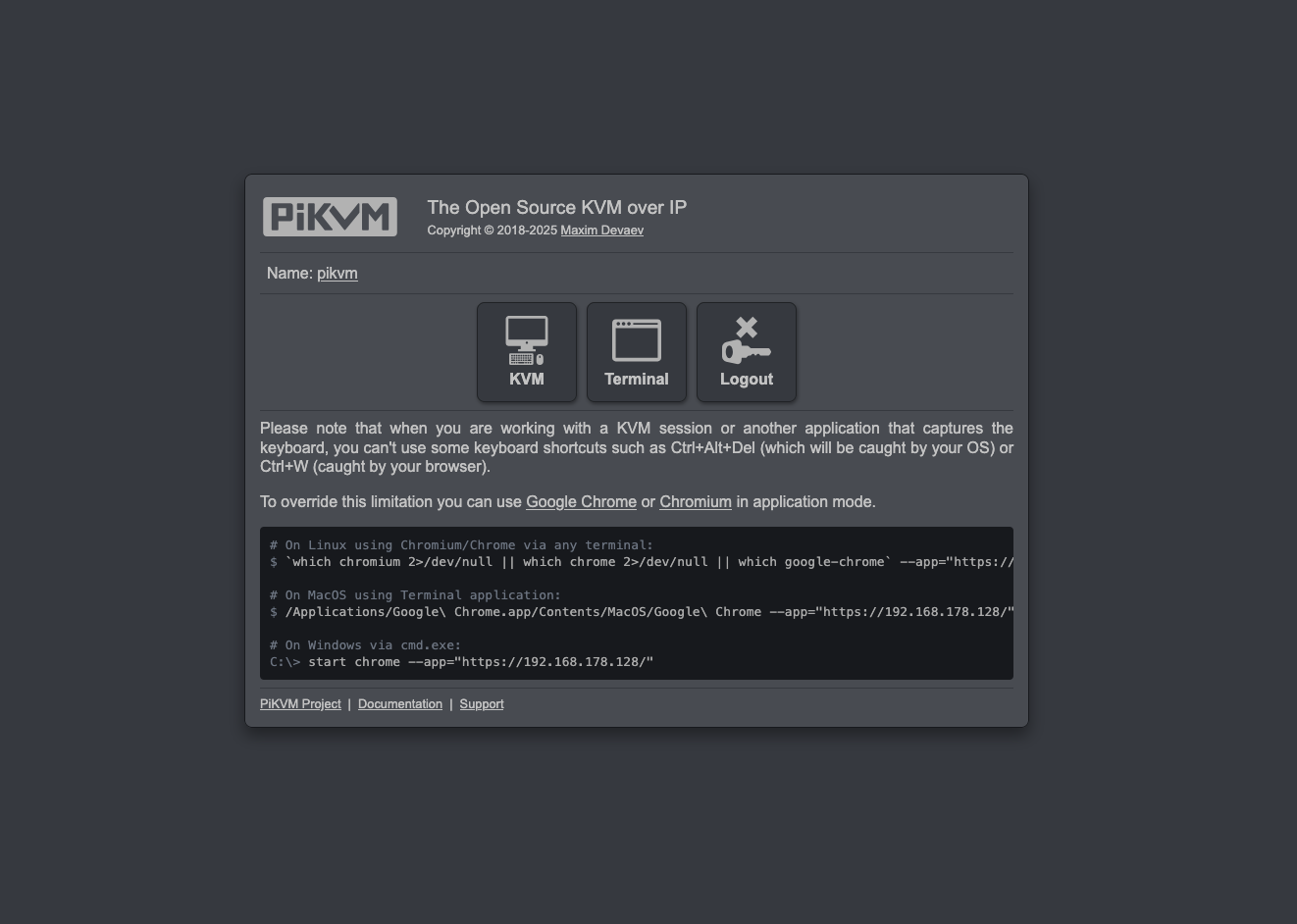

Once logged in, you should be presented with options for accessing the KVM feed and an in-browser terminal session. Confirm that the KVM works as expected (video feed, mouse/keyboard control).
Congratulations, you've successfully built yourself a DIY PiKVM!
