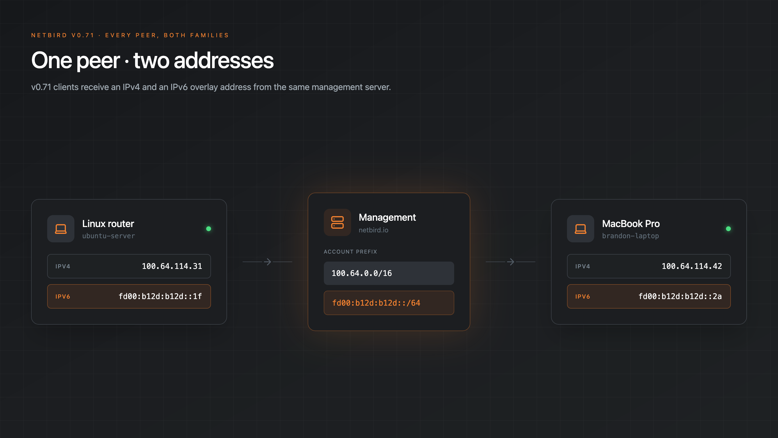

v0.71 changes that. The overlay is now dual-stack. Each account gets a unique IPv6 prefix, peers can receive both an IPv4 and an IPv6 overlay address, and the rest of the system, DNS, firewall rules, exit nodes, network routes, domain routes, follows along.

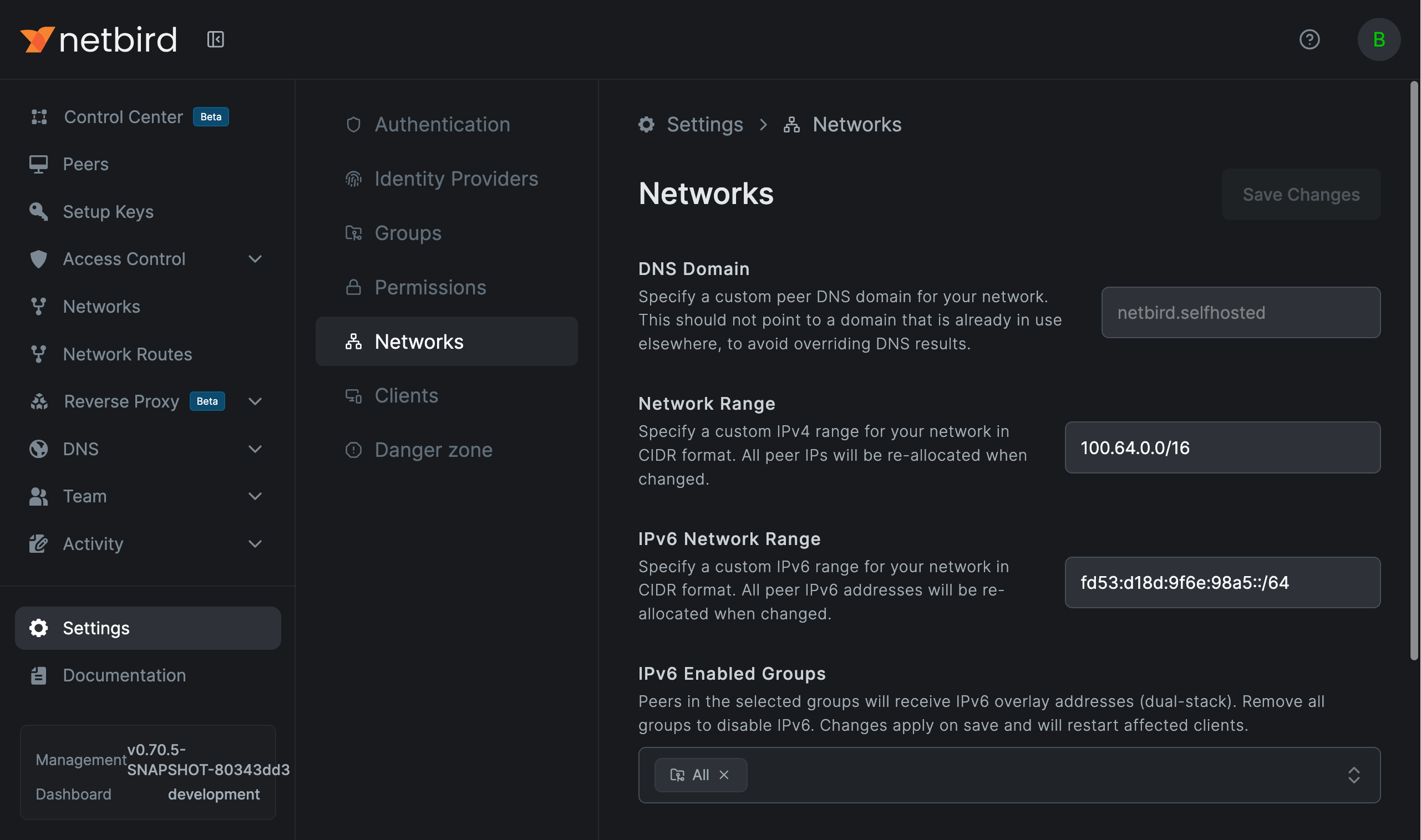

A Per-Account IPv6 Prefix
Every account on v0.71 gets its own IPv6 range alongside the existing IPv4 one. The default is a , which is plenty for any realistic peer count, but you can configure anything from down to if you have a reason to.
The prefix is account-scoped, so two different accounts in the same management server have non-overlapping IPv6 space. This matches how IPv4 overlay addressing already worked and means cross-account routing scenarios behave the same regardless of address family.
Group-Gated Rollout
IPv6 doesn't get force-fed to everyone the moment you upgrade. New accounts have IPv6 enabled for the All group by default, so a fresh install lights it up everywhere. Existing accounts opt in by selecting which groups should receive IPv6 addresses under Settings > Network.
Only peers that belong to at least one selected group get an IPv6 address. Everyone else stays v4-only. This gives you a way to roll IPv6 out to a pilot group, validate things look right, then widen the scope, instead of flipping the whole network at once.

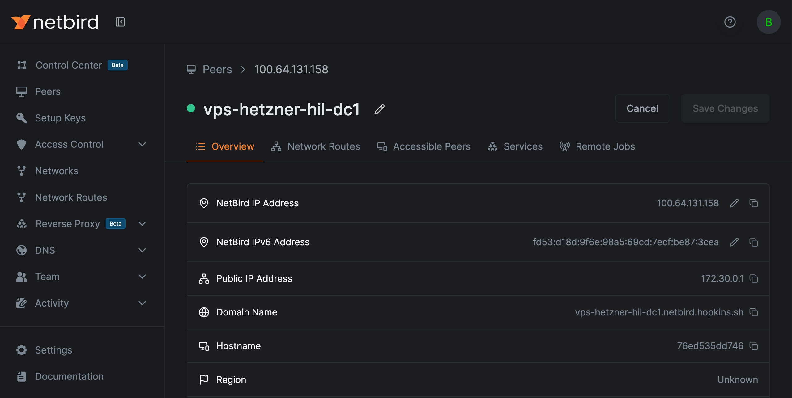

Assignment is also gated on a per-peer capability. The v0.71 client advertises IPv6 support to management on connect; older agents don't, so management skips IPv6 assignment for them even if their group is selected. Upgrade the client and the peer picks up an address on the next reconnect, no manual reassignment required.
Capability is platform-wide: the WireGuard interface picks up the v6 overlay address on Linux (both kernel and userspace WireGuard), macOS, Windows, iOS, Android, FreeBSD, and the netstack/userspace path used for sandboxed environments. There's no platform-specific cutout where v6 is silently disabled.

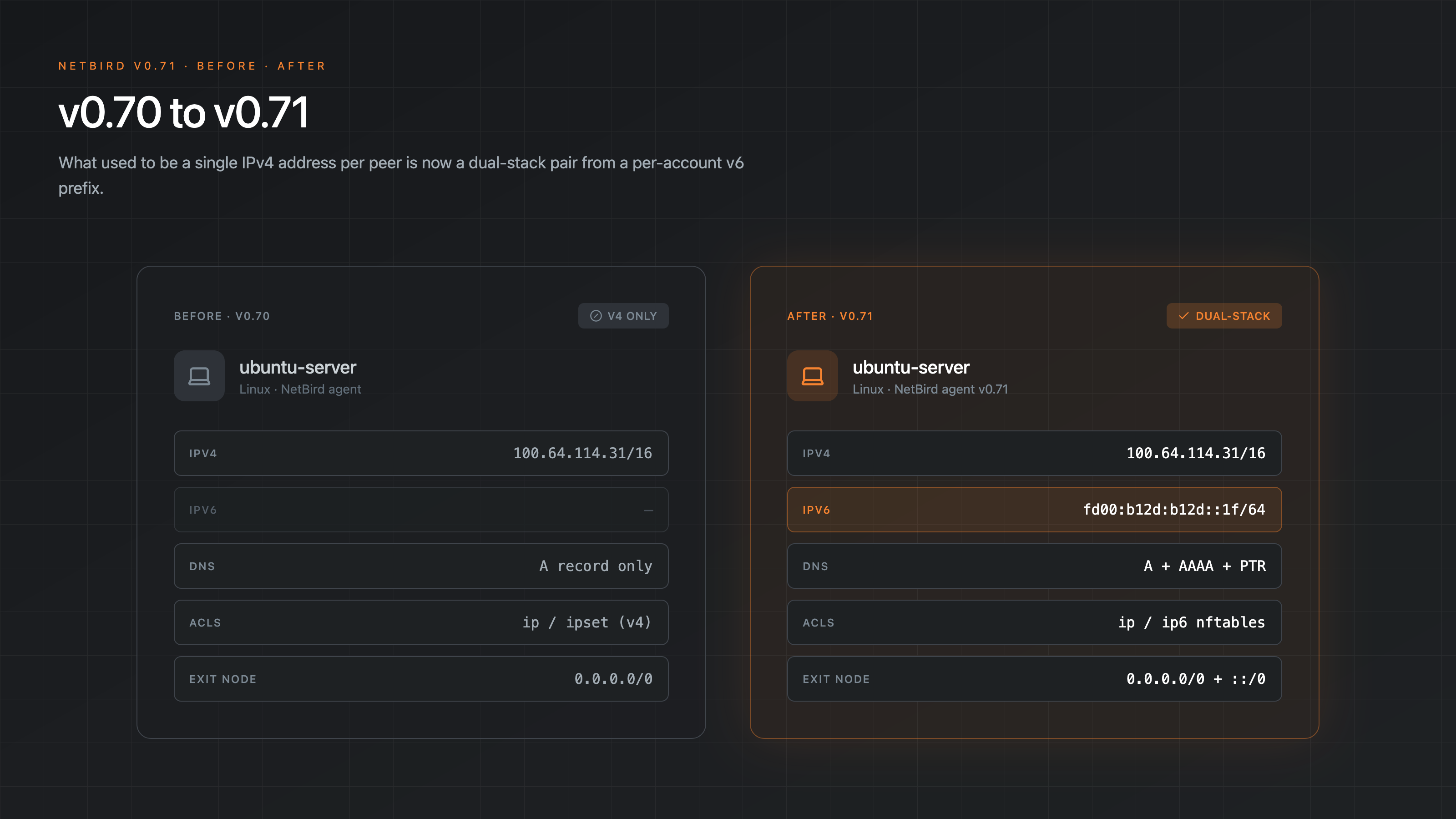

The point of doing this properly is that IPv6 isn't a feature flag bolted onto one corner of the product. Once a peer has an IPv6 address, the rest of NetBird treats it the same way it treats IPv4:
  • DNS serves AAAA records alongside A records from the same NetBird zone, so resolves to both. Reverse DNS works too: PTR records are served from the standard nibble zone alongside the existing , so reverse lookups on overlay v6 addresses return the right peer name in logs and tooling.
  • ACLs apply to both address families. On nftables hosts the client runs a parallel table alongside the v4 one, with its own router and ACL manager; on iptables hosts the equivalent dispatch happens through with -suffixed ipsets to avoid colliding with v4 sets in the global ipset namespace. Either way, management generates the matching rules for v6 whenever a peer has an IPv6 address.
  • Network routes accept IPv6 CIDRs the same way as IPv4 subnets, including masquerade. A routing peer with masquerade enabled SNATs IPv6 egress traffic to its backend-side address, mirroring the v4 behavior.
  • Exit nodes that route automatically get a matching route when the peer supports IPv6, so a "send all traffic" exit node actually sends all traffic instead of leaking v6 around the tunnel.
  • Domain routes resolve both A and AAAA records, so v4-only and v6-only domains both route through the tunnel.
The headline value here is mostly that nothing about your existing policies needs to change. If you already have a group-based ACL letting reach , that policy now applies to v6 traffic too, automatically.

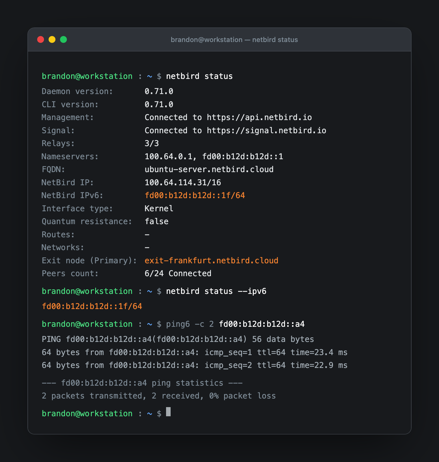

CLI Status
now shows the IPv6 address when one is assigned:
If you only want the v6 address, for instance to feed it into a script, there's a flag for that:
