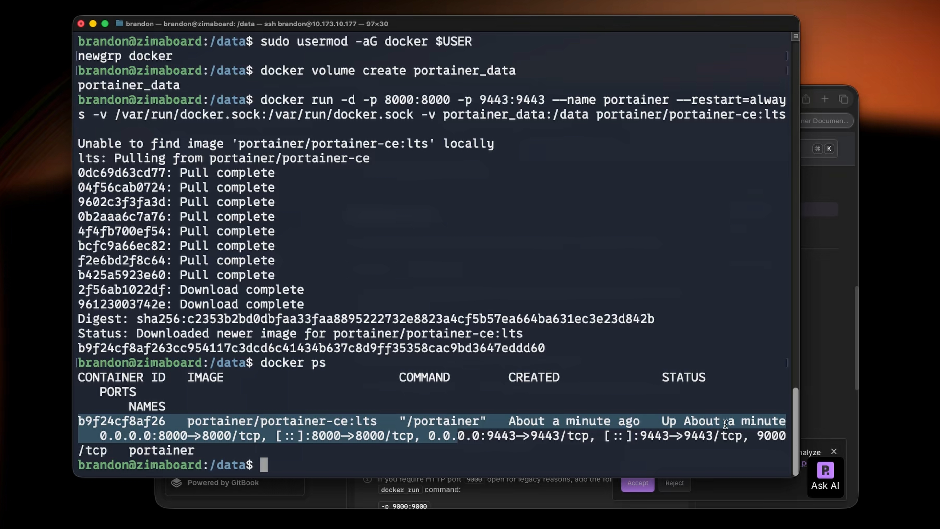

Portainer provides a web-based interface for managing Docker containers, which makes setting up and managing Immich much easier. First let's create our volume for the Portainer data.
Spin up Portainer Community Edition:
Once Portainer is running, access the web interface at . You'll be prompted to create an admin account on first login. The self-signed certificate warning is normal, just proceed.

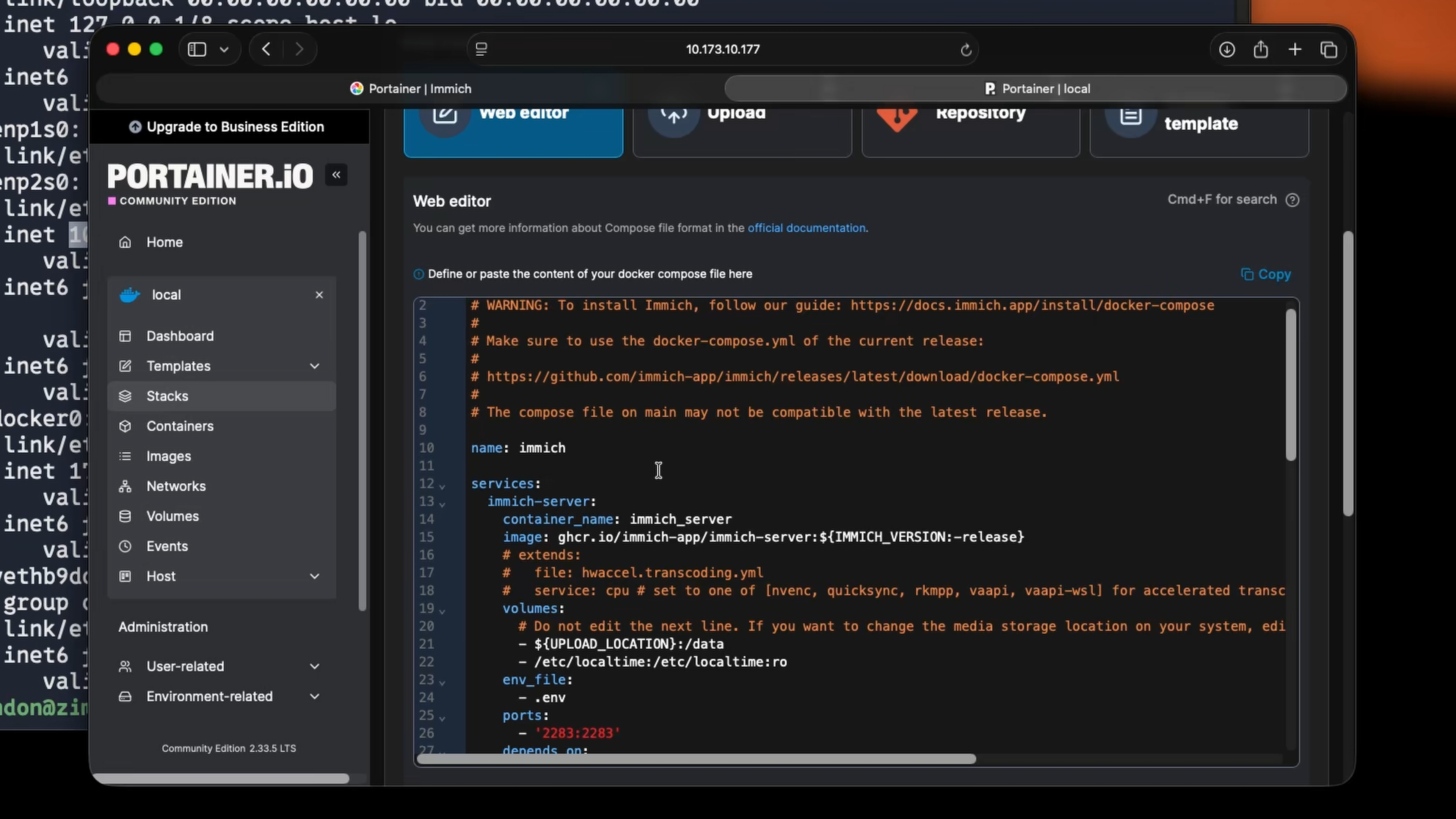

Immich recommends Docker Compose as the installation method, and I agree. We'll use Portainer's Stack feature to deploy Immich, which makes the process much more visual and easier to manage.
  1. In Portainer, go to Stacks in the left sidebar.
  2. Click on Add stack.
  3. Give the stack a name (i.e., ), and select Web Editor as the build method.
  4. We need to get the file. Open a terminal and download it from the Immich releases page:
  1. Copy the entire contents of the file and paste it into Portainer's Web Editor.
  2. Important: In Portainer, you need to replace with for all containers that reference environment variables. Search for in the editor and replace it with .

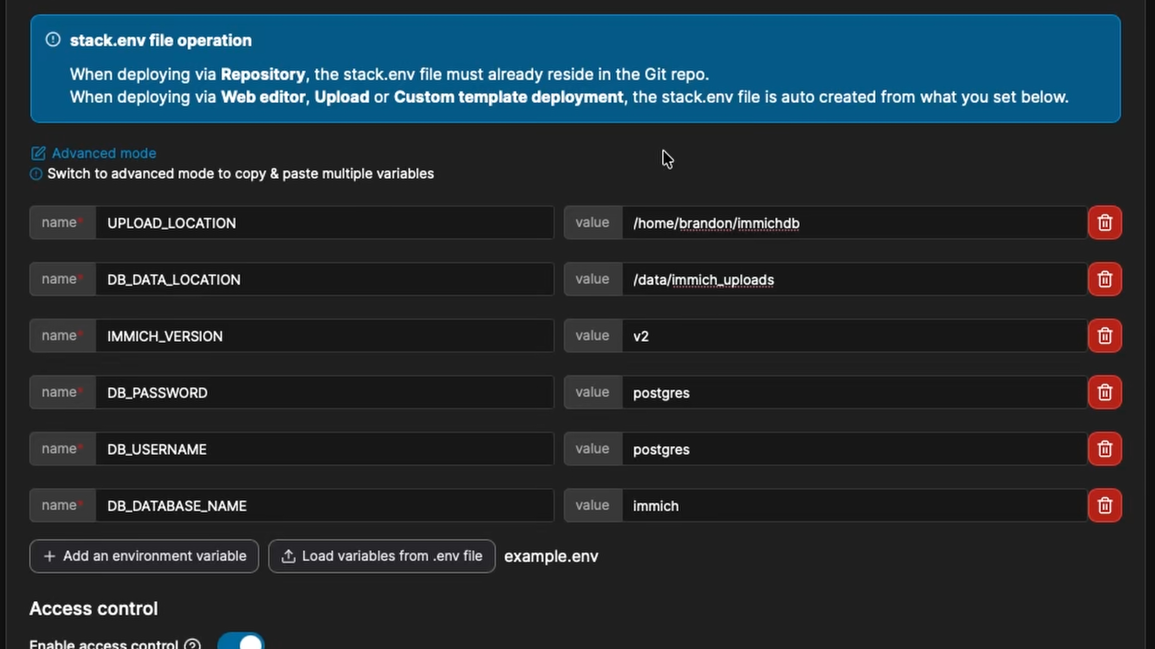

  3. Now we need to set up the environment variables. Click on Advanced Mode in the Environment Variables section.
  4. Download the example environment file from the Immich releases page:
  1. Copy the entire contents of the file and paste it into Portainer's environment variables editor or upload it directly.
  2. Switch back to Simple Mode and update the key variables:
The key variables to change:
  • DB_PASSWORD: Change this to something secure (alphanumeric only)
  • DB_DATA_LOCATION: Set to an absolute path where the database will be saved (e.g., ). This MUST be on SSD storage.
  • UPLOAD_LOCATION: Set to an absolute path where your photos will be stored (e.g., )
  • TZ: Set your timezone (e.g., )
  • IMMICH_VERSION: Set to for the latest stable version
For my setup, the upload location points to an Unraid share where my storage array lives. The database stays on local SSD storage. Adjust these paths for your environment.

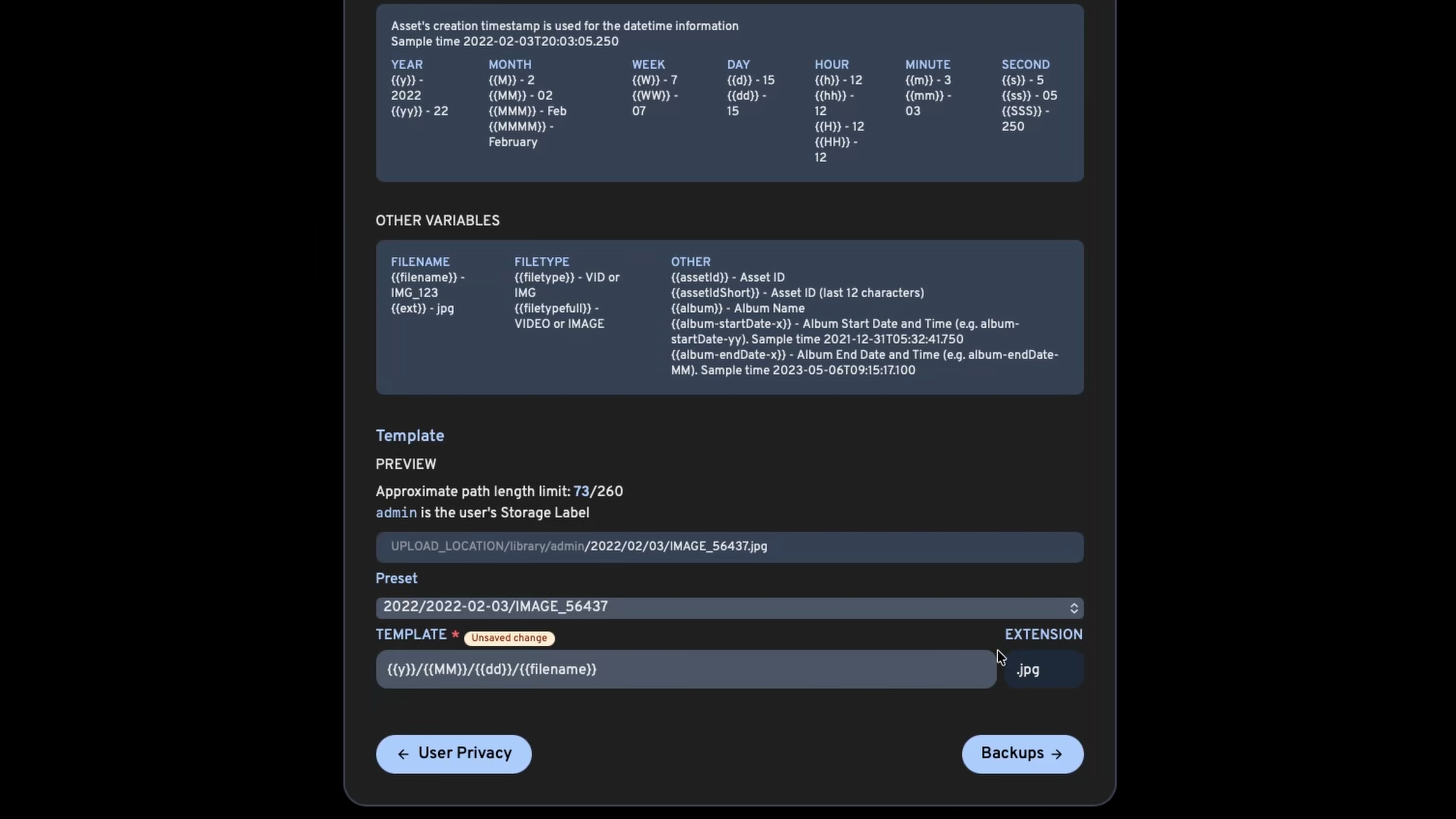

Storage Template Configuration
This is actually important. The storage template determines how Immich organizes files on disk. I use a custom template that creates year, month, and day folders:
This gives me a folder structure like . I don't take a crazy amount of pictures, so daily folders work fine. Adjust this to your preferences, but think about it now-changing it later requires running a migration job.

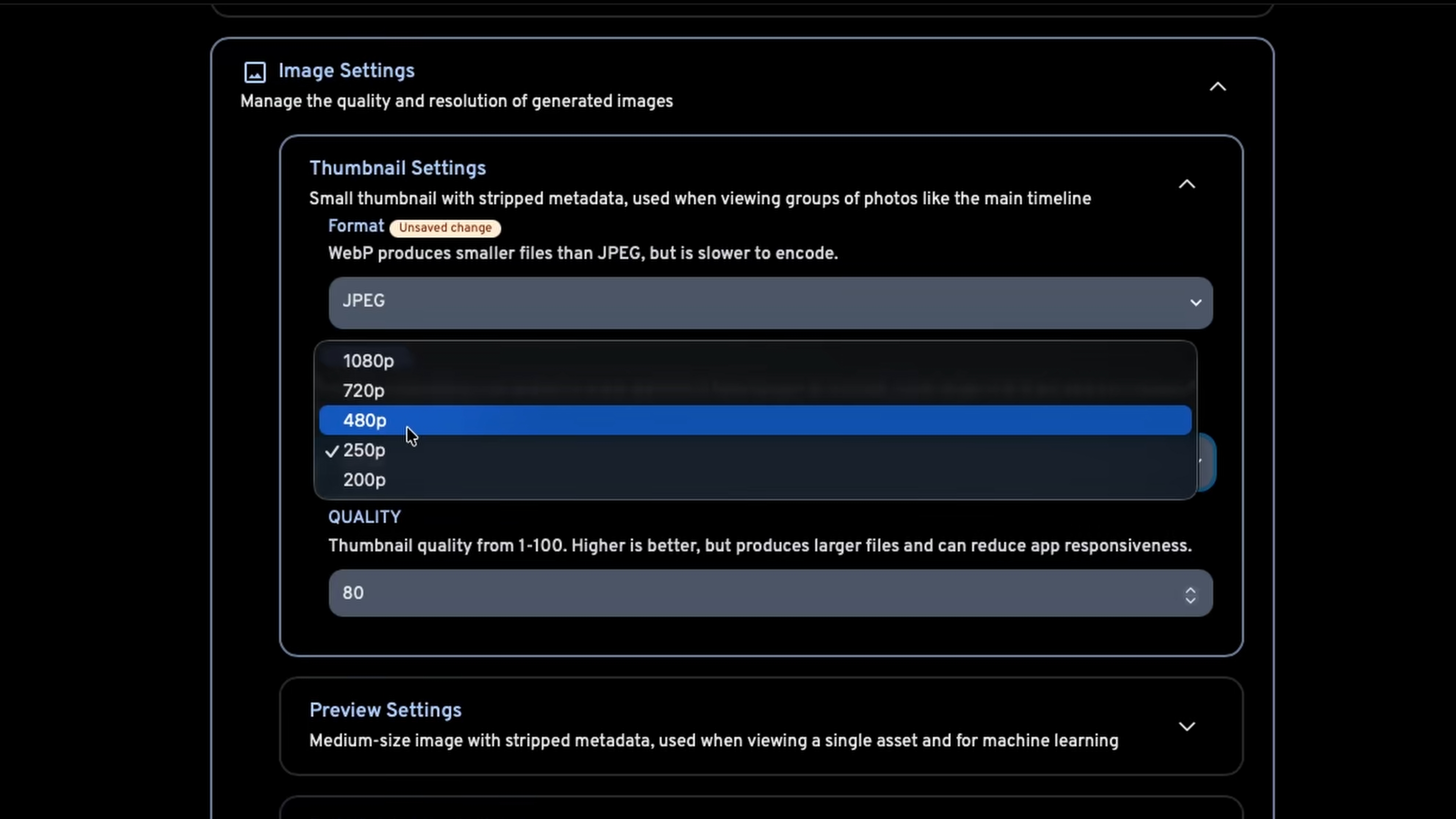

Image Settings: The default thumbnail format is WEBP. I change this to JPEG because I don't like WEBP for basically any situation as it's much harder to work with outside of the web browser.

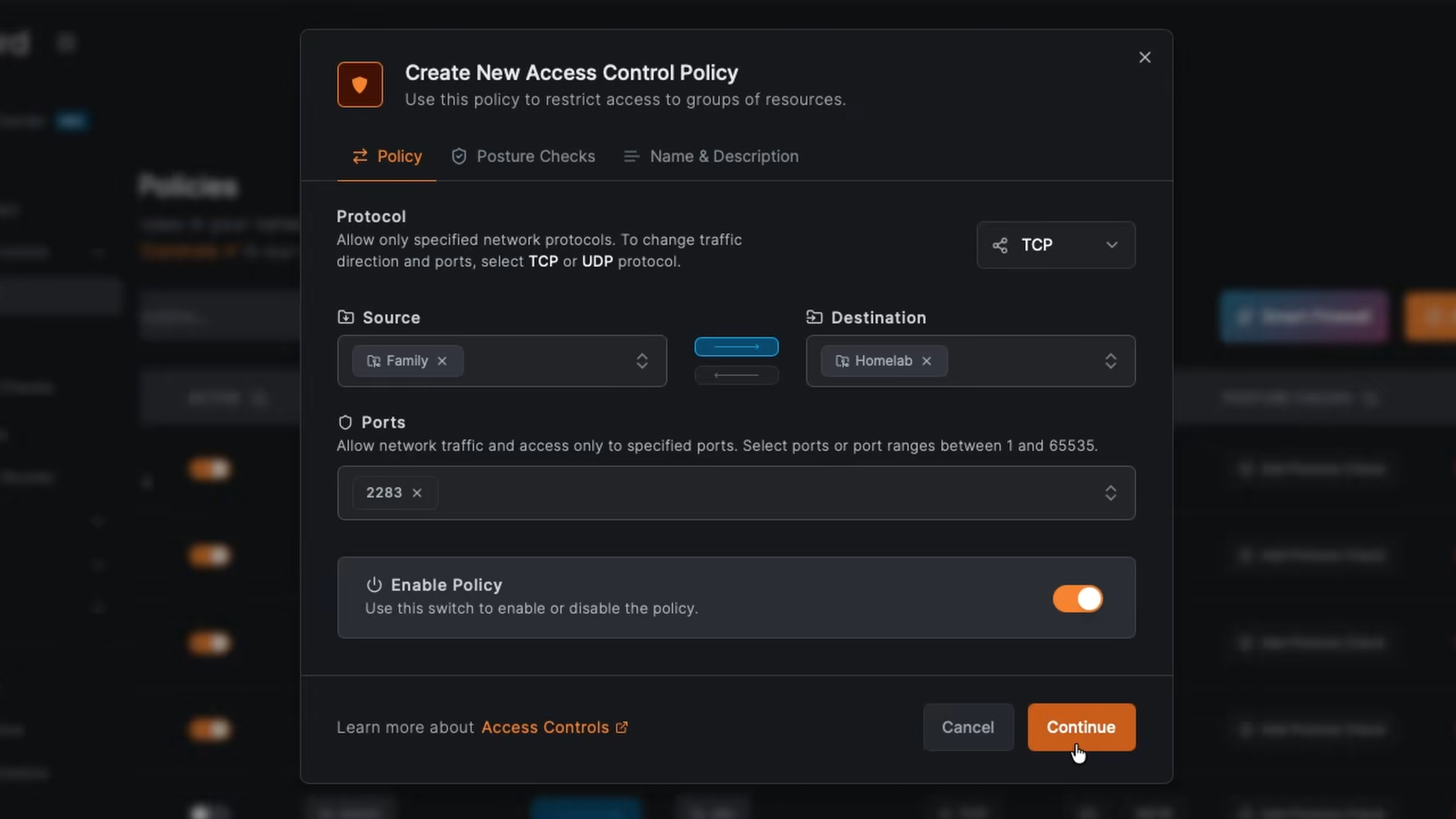

For accessing Immich outside your home network, you have options. You can set up a traditional reverse proxy with something like Nginx or Caddy, but I use NetBird. No exposing ports or needing to setup a proxy.
You can add your Immich server as a peer:
Then in the NetBird dashboard, create an access policy that allows your devices to reach port 2283 on the Immich peer. Now you can access your instance from anywhere using the NetBird DNS name or peer IP.

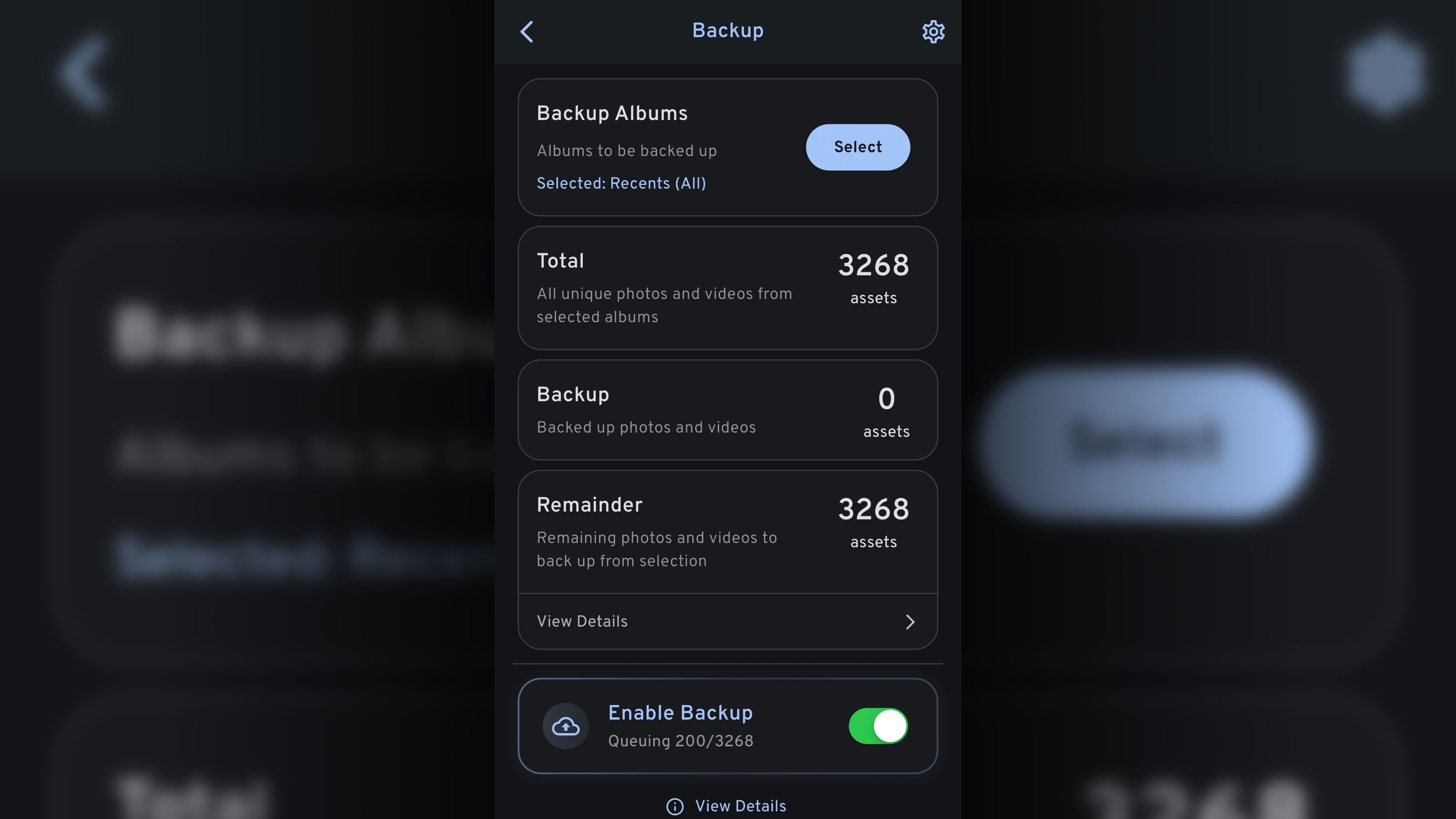

To enable automatic backup, tap the cloud icon and select which albums to sync. Under settings, you can configure WiFi-only backup and charging-only backup to preserve battery and cellular data. The storage indicator feature shows a cloud icon on photos that have been synced, which helps you know what's backed up.
iOS users should enable Background App Refresh and keep Low Power Mode disabled for reliable background uploads. Android handles this better out of the box but might need battery optimization disabled for the Immich app.
