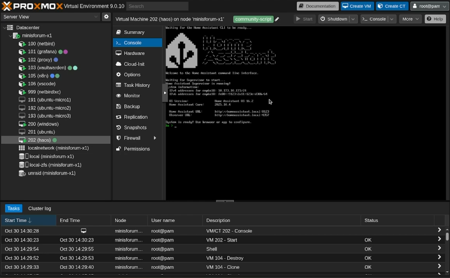

The Proxmox VE Helper Scripts (originally created by tteck, now maintained by the community) make this a one-command process. In your Proxmox shell, run:
The script walks you through the setup. Defaults are fine for most people. It downloads the latest HAOS image, creates the VM, and configures the hardware. If you want to tweak disk cache, CPU type, or storage location, select "Advanced" when prompted.
Once the script completes, start the VM. You can check the console in Proxmox to find the IP address Home Assistant was assigned.

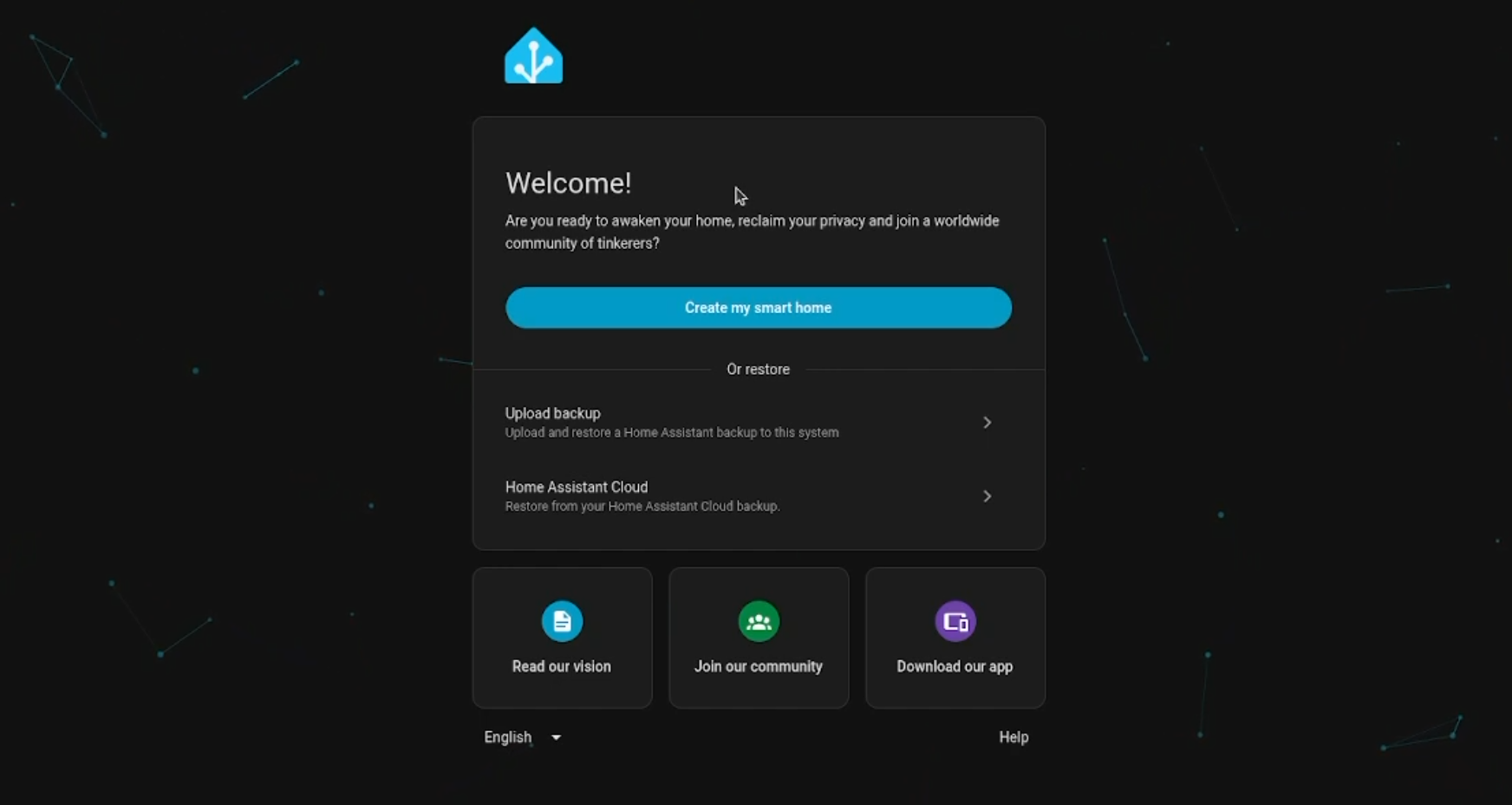

Open a browser and navigate to . The first boot can take a few minutes as Home Assistant downloads and installs the latest components, so be patient.
You'll be greeted with the onboarding wizard:
  1. Create your admin account with a name, username, and password
  2. Set your home location (used for time zone, weather, and sun-based automations)
  3. Choose your country and language
  4. Home Assistant will auto-discover any compatible devices on your network
Once you're through the wizard, you'll land on the dashboard. Home Assistant is up and running.

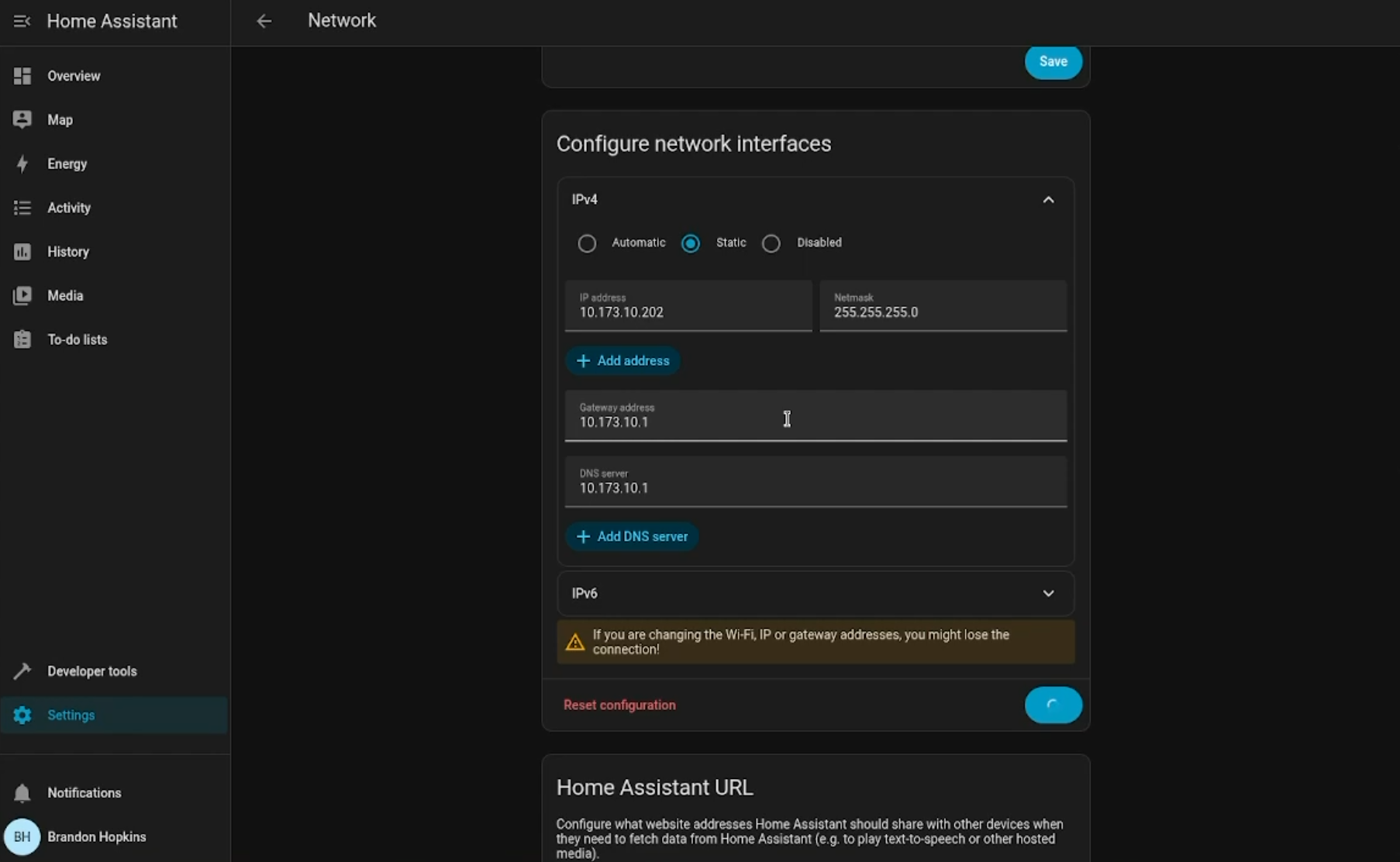

Before going further, give your Home Assistant instance a static IP so the address doesn't change. You can do this through your router's DHCP reservation, but Home Assistant also lets you set it directly in the UI.
  1. In Home Assistant, navigate to Settings > System > Network
  2. Under IPv4, click on your active network adapter
  3. Change from Automatic (DHCP) to Static
  4. Enter your desired IP address, subnet mask (typically or ), gateway (your router's IP), and DNS server
  5. Click Save
Tip: Choose an IP address outside your router's DHCP range to avoid conflicts. If your router assigns addresses from to , pick something like .
After saving, Home Assistant will switch to the new IP. If the address changed, you'll need to navigate to to continue.

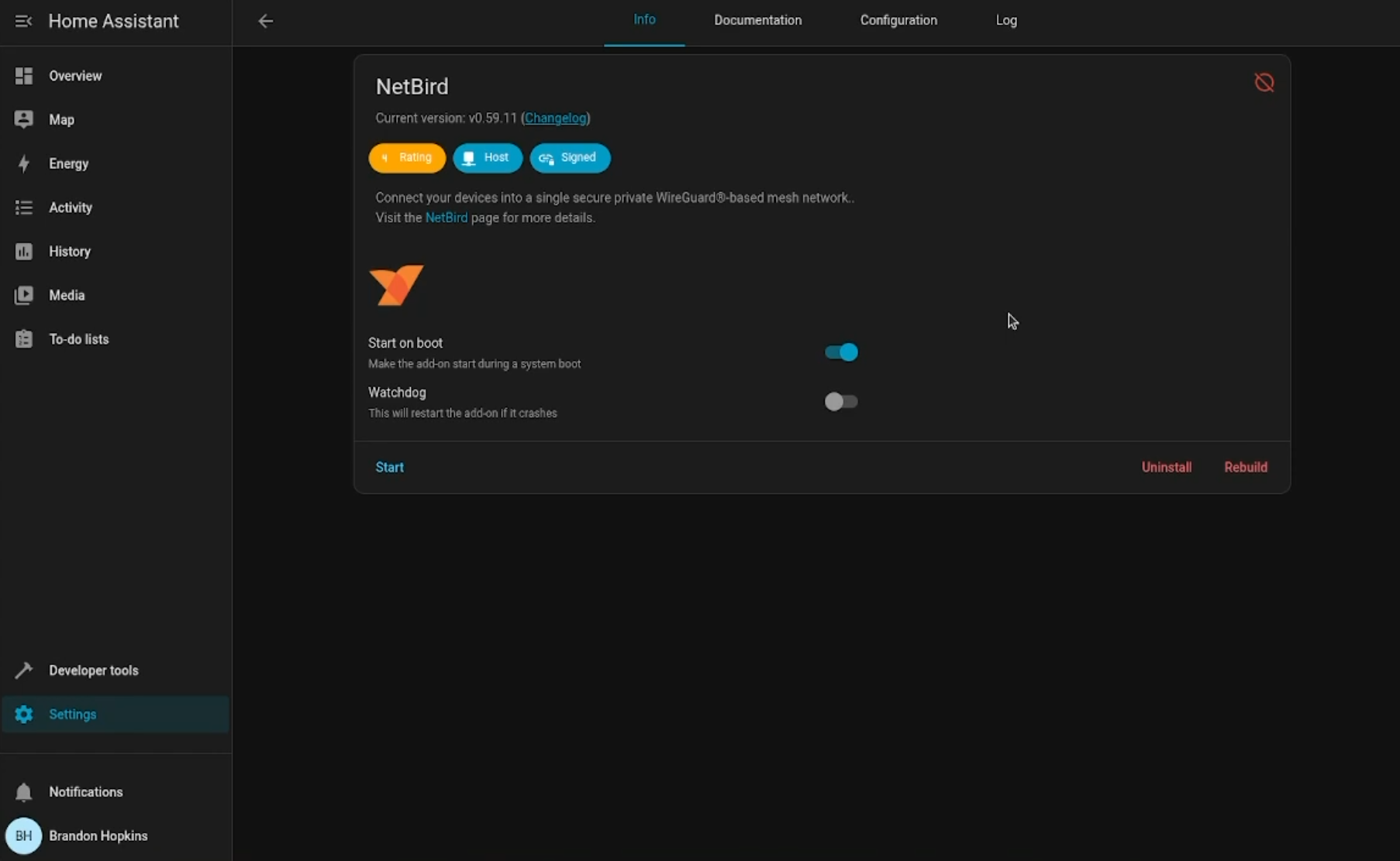

  1. Click on the NetBird add-on and click Install
2. After installation, go to the Configuration tab 3. Set the following options:

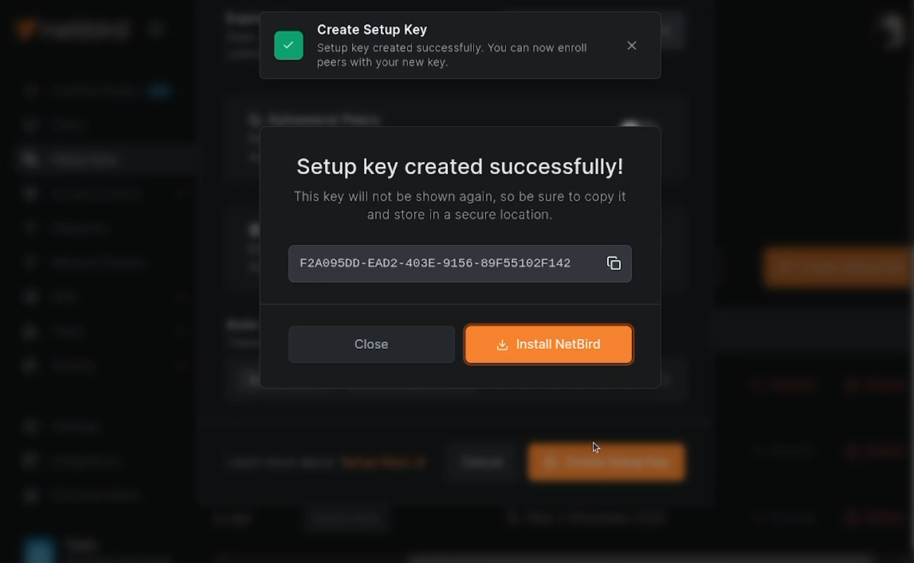

If you're using NetBird Cloud:
  • setup_key: Paste a setup key from your NetBird dashboard (Setup Keys > Add Setup Key)
If you're using a self-hosted NetBird instance:
  • setup_key: Paste your setup key
  • admin_url: Your NetBird dashboard URL (e.g., )
  • management_url: Your NetBird management URL (e.g., )
  1. Optionally set a hostname to give your Home Assistant instance a recognizable name in the peer list (e.g., )
  2. Click Save and then Start the add-on
  3. Enable Start on boot so NetBird connects automatically when Home Assistant restarts
Check the add-on logs to confirm it connected successfully. You should also see the peer appear in your NetBird dashboard under Peers.

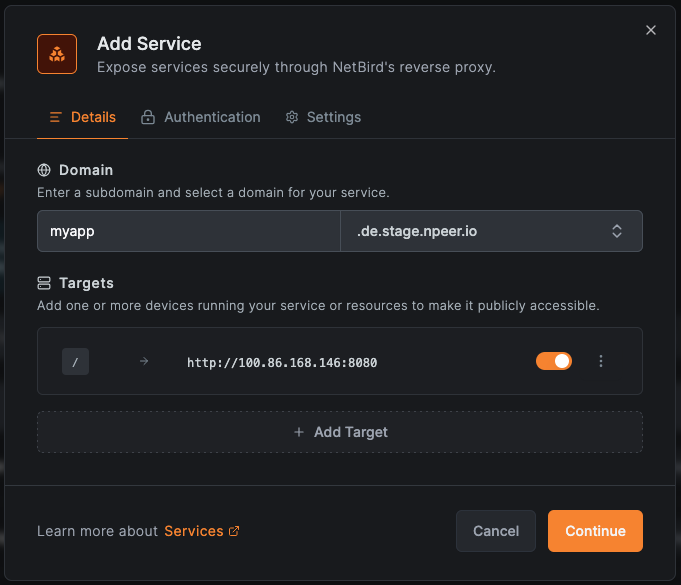

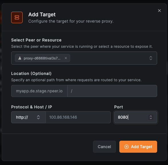

  1. In the NetBird dashboard, navigate to Reverse Proxy > Services and click Add Service
  2. Enter a subdomain (e.g., ) and select your proxy domain
  1. Click Add Target and select the Home Assistant peer (or the network resource if you're using a routing peer)
  2. Set the protocol to HTTP and the port to 8123
  1. Under the Settings tab, enable Pass Host Header and Rewrite Redirects
  2. Under the Authentication tab, configure authentication (see below)
  3. Click Add Service
Wait for the status to show "active" and go to your new URL (e.g., ). You should see the Home Assistant login page. That's it. Home Assistant is on the internet with no ports open on your home network.
